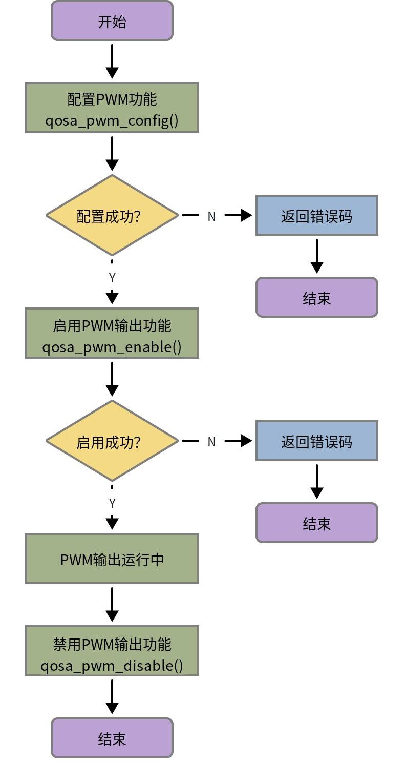

应用逻辑流程图
示例代码
完整示例代码请查看 https://github.com/UniRTOS/UniRTOS-Doc-Examples/blob/main/peripheral/pwm/pwm_demo.c
