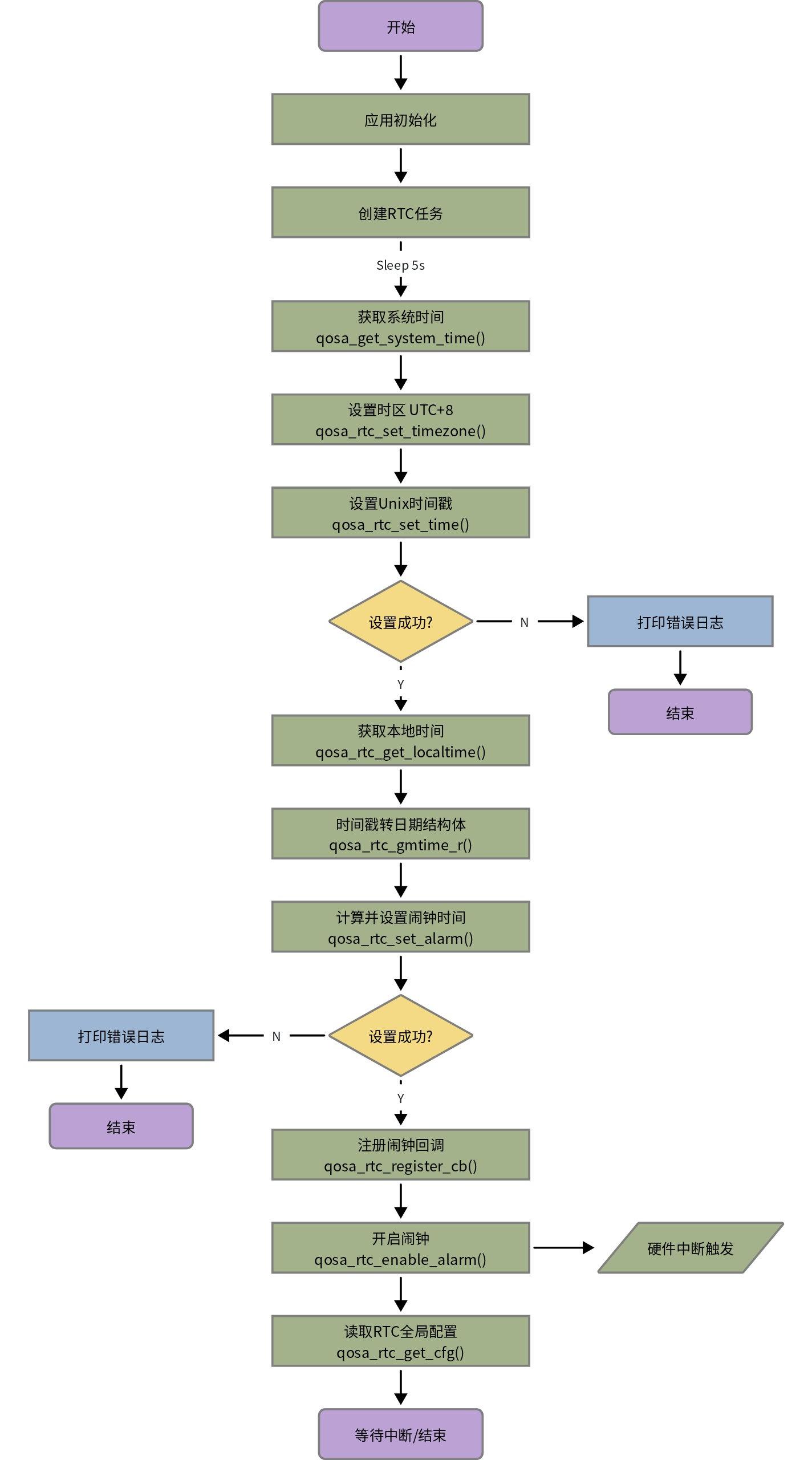

应用逻辑流程图¶
示例代码¶
完整示例代码请查看 https://github.com/UniRTOS/UniRTOS-Doc-Examples/blob/main/peripheral/rtc/rtc_demo.c
