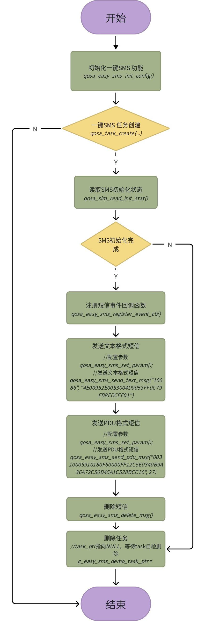

应用逻辑流程图¶
示例代码¶
完整示例代码请查看 https://github.com/UniRTOS/UniRTOS-Doc-Examples/blob/main/application/one_touch/sms/easy_sms_demo.c
