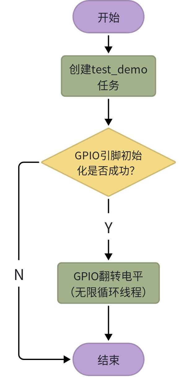

unir_led_demo_process¶
功能描述
线程处理函数,实现LED的闪烁逻辑,即每隔1秒翻转一次GPIO输出电平。示例代码
static void unir_led_demo_process(void *ctx)
unir_led_init();
while (1)
unir_led_set(QOSA_GPIO_LEVEL_LOW);
QLOGI("[led]]LED ON");
qosa_task_sleep_ms(1000);
unir_led_set(QOSA_GPIO_LEVEL_HIGH);
QLOGI("[led]]LED OFF");
unir_led_demo_init¶
功能描述
示例程序的初始化入口函数。该函数调用 qosa_task_create() 创建线程任务,并将 unir_led_demo_process() 指定为任务入口函数。示例代码
void unir_led_demo_init(void)
// Log the entry of the LED Demo initialization
QLOGV("[led]]enter LED DEMO !!!");
// Create a task for the LED Demo using qosa_task_create, with specified stack size, priority, name, and entry function
if (g_quec_test_demo_task == QOSA_NULL) // Check if the TEST Demo task has already been created
qosa_task_create(
&g_quec_test_demo_task,
UniRTOS_LED_DEMO_TASK_STACK_SIZE, // Task stack size
UniRTOS_LED_DEMO_TASK_PRIO, // Task priority
"test_demo", // Task name
unir_led_demo_process, // Task entry function
QOSA_NULL // Task context (not used in this case
应用逻辑流程图¶
