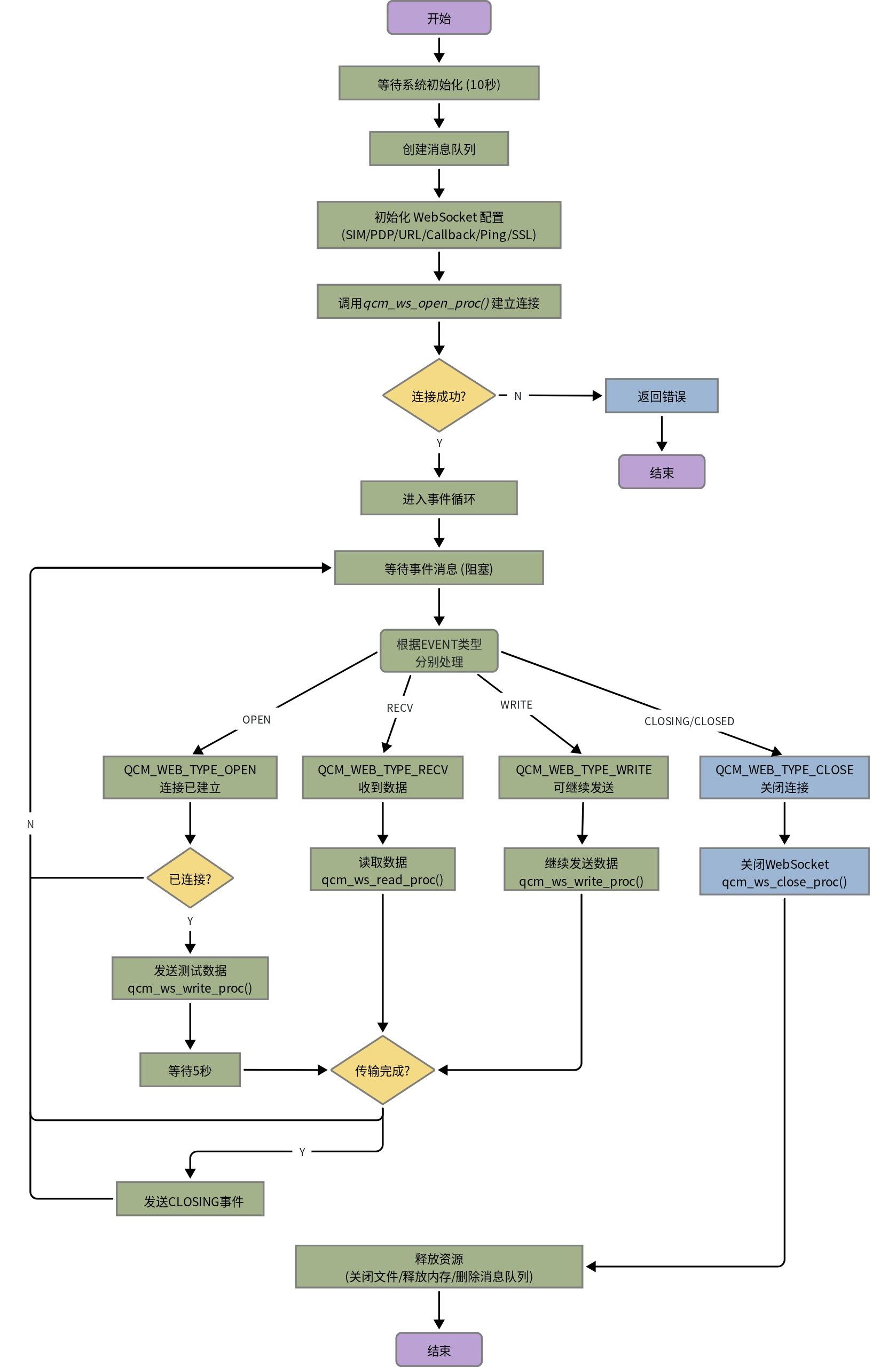

通信流程
../../../_images/image_Hvgfb3lv7oPp9Exy1LUcDXvjnZg.webp

应用逻辑流程图
../../../_images/board_PwwewvdAJhlqq5bXfmQcS1XLn2d.jpg
示例代码
完整示例代码请查看 https://github.com/UniRTOS/UniRTOS-Doc-Examples/blob/main/network/network_protocol/WebSocket/WebSocket_demo.c
